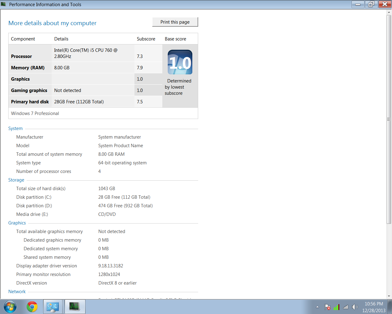

ok i got a big problem i was in a game other day and i got a blue screen of death the pc restarted itself and was ok for another 3 hours then same thing happened again and it was basically screwed and wouldnt let me on.
I had to go on safe mode and reinstall windows 7 doing this it got me back on but the big problem now is if i download geforce driver GTX 470 it blue screens of death after install and restart! then i have to go on safe mode and uninstall it and i get no blue screen of death.
I aint got a clue what it could be accept for graphics card i think but i aint no comp expert.
hope it aint whole pc fucked cus it cost me 1400 quid also my keyboard letter are pretty screwed and some letters like @ and # and few others have switched around :( please help !!!!!!!!!!!!

Driver: Try installing an older version of the same driver and see if you encounter the same issues. Let us know.
Keyboard: Try playing around with the settings for your keyboard layout. Odds are windows just thinks you have a different layout keyboard than you actually have.

still same problem soon as i download any version it says restart so i restart and it trys loading up saying windows is starting then it goes to blue screen of death :/ i see many people had same problem with this gtx 470 :/

Download this version http://www.nvidia.com/object/win8-win7- ... river.html Install it. If it doesn't work check your temps. If it is abnormal it means it is faulty. The only possible thing you could do now is get an RMA. If you happen to have another video card, test that one out also.
When you get the BSOD check to see if there's anything that says "nvlddmkm.sys" or any artifacts (abnormal colors, lines), if you see that then its guaranteed a defective card.
For your keyboard, you probably bought your computer from a US vendor so you are using US keyboard layout. Change your keyboard layout to UK.

Sounds like something (most likely your GPU) broke. Troubleshooting is hard, so prepare for an odyssey. You may try to plug your GPU into another computer and check if it works there, if it fails there as well you can be pretty sure it's broken. You may also try to find older driver versions and install them.

Tried to install old drivers and new but when ever they install it blue screens when restarted i think something must be screwed on it. I ordered a new graphic`s card now for 80 quid so im hopeing it should work perfect after that if not im coming to ghosts house and gonna kick his ass :) :twisted:
