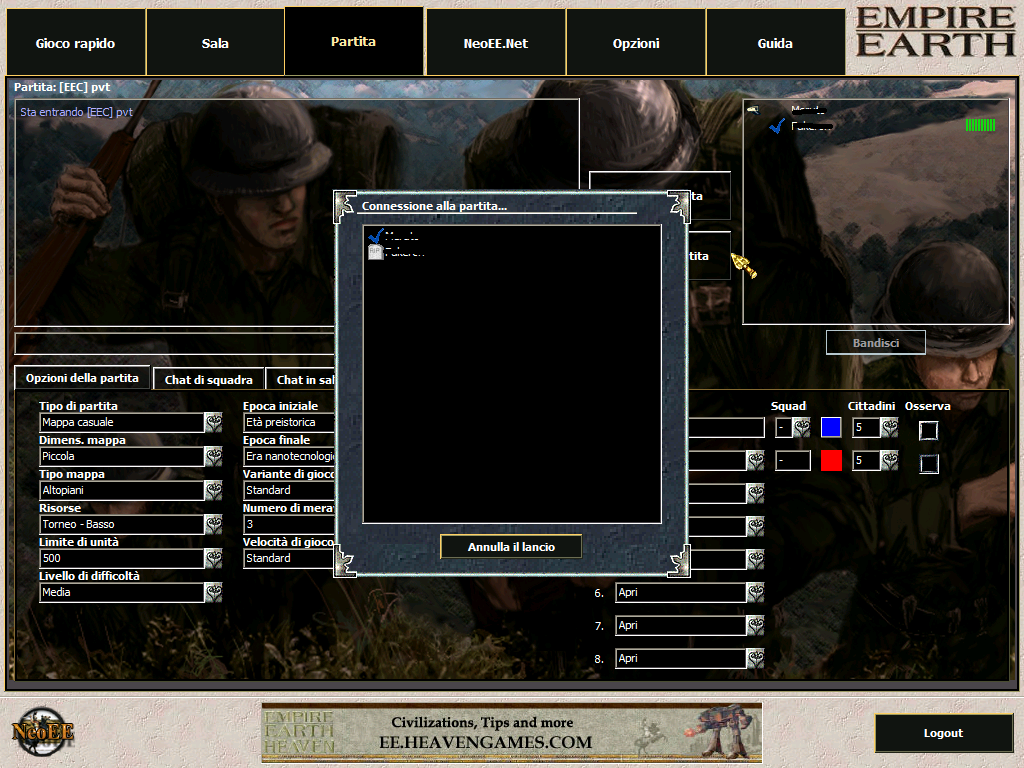

Basically in the picture you can see what happens not only on my other laptop right now but even with my friends when we try to join the game.

ah okay AOC, so first of all NeoEE host system is only for EEC. The only thing i can think of causing this issue is that your ports arent forwarded correctly. What i would do , is to find someone who has opened ports and test with him, so you know whether its your host being the problem or the players who try to join. You can contact me in Lobby as "Die Gurke".
Also maybe try to contact Jodocus, hes the one building this lobby and probably best in this stuff.
