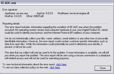

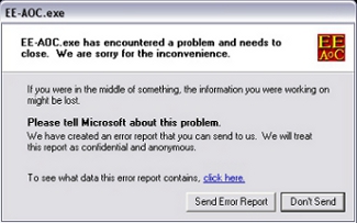

No matter how many different downloads I try, and how many times I uninstall and reinstall Empire Earth Art of Conquest, whenever I try to start the game, it first looks like that it will run, but it doesn't.
When I double-click on the game, for 3 seconds I get the black screen, then the game quits back to my desktop and then I get an error reporting from the Empire Earth Art of Conquest executable file.
The original Empire Earth works perfectly fine, but the expansion won't run. Could there be some problem with my computer or is it something else?

use the actuall exe from the folder not a shortcut you made (shorcuts dont work on my comp)
if that dont work do an uninstall then repair and use the folder exe again
if none of those work post the actuall error here

Yes I copied the no cd crack over the original exe file and no I did not use a shortcut.
When I looked in the data folder, it looked like some files were missing. There were files in the original Empire Earth data folder that I did not see in the Art of Conquest expansion data folder. That might be the problem, but every download I try the data folder looked the same. So I'm not sure if that's is the problem or not.
Hey, if you have the Art of Conquest expansion, and it works, maybe you can right click the data folder and then click on properties and tell me how many files and folders it has for me?
If you have a bigger number than I do, then I'll go figuring out where the missing files went.
If you have the same number, then something else is the problem and not the data folder.
Or maybe it's the Low-Level Engine.dll problem? Could it also be that I have to adjust some setting in my computer?
I'm lost, I don't know what to do, and I really want to play Empire Earth Art of Conquest.
