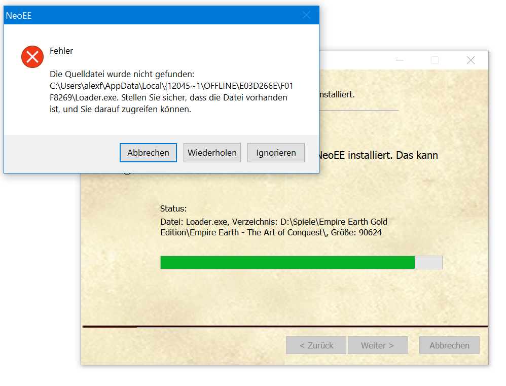

Hello,
while installing the patch i always get these message
I dont know what i can do.
I have installed the GOG Version of the game.
Thanks for your help.

Hi. It's the antivirus that is deleting the high-resolution lobby loader. You can ignore it and use the lobby in low resolution or you disable your antivirus during installation.

Jodocus wrote:Hi. It's the antivirus that is deleting the high-resolution lobby loader. You can ignore it and use the lobby in low resolution or you disable your antivirus during installation.
And with "run it in low resolution" you mean run "Empire Earth.exe" in the installation folder directly instead of clicking the shortcut which probably uses "Launcher.exe" in your installation folder, right?

Exactly. If you inspect the properties of the shortcut, you see that it calls Launcher.exe with the additional resolution parameters that the launcher then uses to override the memory locations of EE.exe. This process is considered as "virus-like" by almost any antivirus program.
